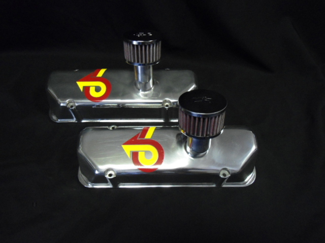

The engine guy called and we're probably 2 weeks out from getting the short block here, and we found the elusive Even-Fire flywheel.
Anyone doing a Buick should know about this shop - they have been incredibly patient and helpful: http://www.taperformance.com/products.asp?cat=141
And we found a sweet set of rocker covers.
- Valve Covers.jpg (145.51 KiB) Viewed 32432 times

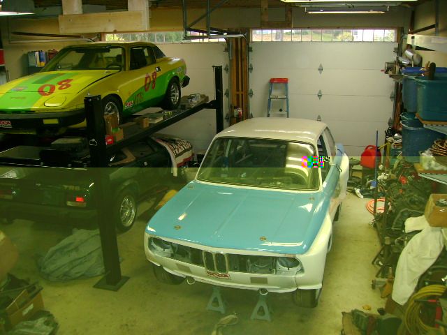

I found this thread doing a little internet surfing. I ran COM many years ago in a TR8 coupe. Around 95 or so I switched over to SCCA ITS in the TR8. Still have the car, but it hasn't seen the track in several years. Thinking about getting back into some track days this year, as I have a couple of buddies that still run often with COM. I might be of some help to you if your still building the TR7. I have 7 TR8s and a couple of TR7s now. Lots of experience building, restoring and racing these things. Everything from TR7 16Valves to highly modded TR8s. Built several cages for them as well. There is a treasure trove of parts out in my garage. I even have a bunch of Buick stuff. Glad to help if I can. I'm located just off Cape. I'll add a couple of pictures of the race cars as soon as I figure out how it works around here.
Re: TR7 Build String
Here you go. ITS TR8 and an EP/vintage BMW 2002.

Jeff Baker, this is not a dream. You just found a new best friend!!
