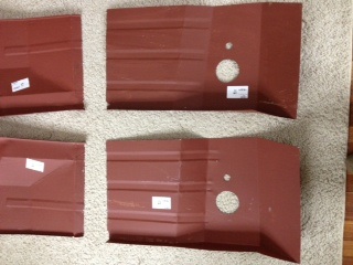

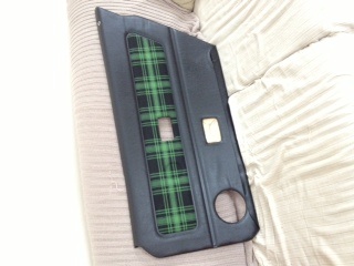

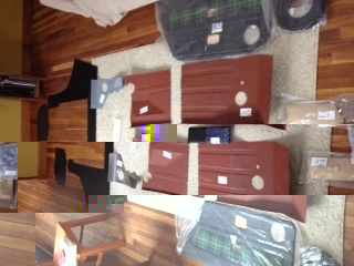

So the Rimmer order came in. I've got a TR7 kit on my living room floor!
Notice the problem with the floor pans? Two of the same side...gotta get that fixed ASAP.
Love the plaid interior, though.
We really start cutting this afternoon. See you at the banquet, I hope!

Re: TR7 Build String
Boy..does that door panel scream 70's!
